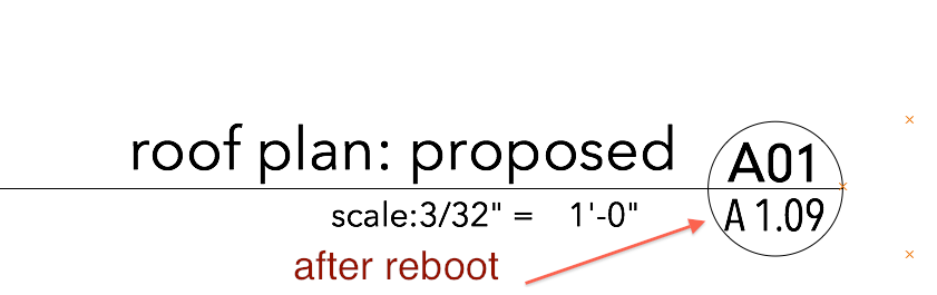

After the last update to Mac OS 10.6.7 I found out that the text for "Layout Number" using "NCS Drawing Title 2 14" changes size automatically.
If it is the first time you open AC the text is one size.
If you close AC and reopen it the size shrinks.
If you try to edit only that text in the title by selecting all the drawings using "Drawing Manager" then AC also changes the length parameter, position and alignment of all the titles. In this project I already have more 200 drawings which presents a problem when trying to fix the problem globally.

After Relaunch

and the result of the undo after trying to edit all the titles at the same time.

Seems to be an osx 10.6.7 problem affecting a lot of people, I have different but related problems after upgrade - workaround proposed by some is downgrade to 10.6.6
Eduardo Rolon
Thanks for the suggestion,
It might be Apple's fault but it is not affecting the size of the font in other areas of Archicad were I am using the same font. This is not the only Open Type Font I am using in that project.

Several sources confirm a bug in the 10.6.7 system update with Open Type Fonts. Here is a good review:
http://reviews.cnet.com/8301-13727_7-20048314-263.html
This seems to affect output too, meaning that PDFs saved from ArchiCAD may not open on Windows, and may not print.
Apparently the workaround is to either use non-open type fonts or re-installing the system and installing 10.6.6 update (omitting 10.6.7)

Besides the windows problem I can confirm that it is also causing problems with other Preview in other Macs if they do not have that font installed.
