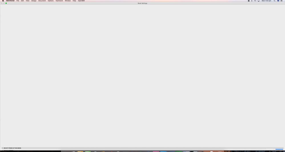

Hi everyone,
Have been having some issues with booksetting on AC20 on a teamwork file and was wondering whether anyone could help.
Whenever I try to access the booksetting a blank grey screen pops up with all the tabs collapsed to the bottom of the screen. When I try to do anything further Archicad crashes This issue is isolated to only one of my files and doesn't seem to effect any other project files, so I don't think it's got to do with the hardware or the software. Something got to do with this specific file.
I tried opening up an archived file and booksetting works fine. So I am not too sure whether it's something I have done on the file since that's causing this problem. I could always go back to the archived file but I would lose 3 days of work.
Has anyone faced a similar problem?
I am on MacOS Sierra and both Archicad and MacOS are up to date.
Thanks in advance.

Thanks Barry, I tried what you suggested by saving off a copy on my desktop and through process of elimination I started deleting off layouts, masters and other elements but still no luck, same issue.
Just to test it out further, I tried deleting ALL layouts and masters as well as all view settings, and this fixed the issue. So my assumption is there's something in the the above settings that's causing the issue.
Hoping to find someone who had a similar problem and found a solution for it.

I had this problem on Archicad 20 Teamwork on Windows.
The solution I found online was to save the Teamwork file as a PLN, shut it down and then "Open & Repair selected file". You find this when you browse for a solo project when you start Archicad.
Hope this helps..
Hope this helps..
Thank you! This solved the issue.
I have also sent the file to Graphisoft for investigation.
