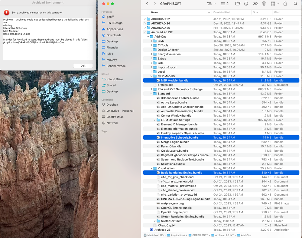

It appears all the 600x updates have been pulled. Not before I ran it on 26 INT which now won't open. (It's not the open delay, that is another bug), I get the following error. I can assure you the listed add-on are indeed located in the proper folder. Sorry but this is an embarrassing sh*t show. Between the Sonoma crashes and this debacle Graphisoft quality control appears nonexistent.

Hi Eduardo:
Thanks for posting, but for the life of me, I cannot find that subdirectory, unfortunately.
If anyone has used this workaround successfully, please post about it! I set a timer on my watch for 15 minutes to see if it does in fact open after "10-15 minutes"; wish me luck!

Hi all:
I wasn't able to find the "IPC Data" sub-directory noted in this workaround post, but I did fire up AC 26 6002, and it did finally start up - after about 25 minutes. There was no sign of any activity at all, but I just did other stuff, and eventually it popped back up. Just FYI.
