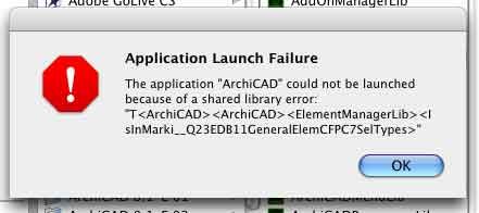

Just installed this update on two computers. With one it worked fine on the other when I start up ArchiCad I get the error shown in the file attached below.
Any ideas how to fix this or do I have to re-install ArchiCAD?

Sorry mate,
Looks like you are in for a reinstall of ArchiCAD on you computer.
Please refer to this thread http://archicad-talk.graphisoft.com/viewtopic.php?t=5501 for further details

Thought I'd use this thread to post a question about the update. One of the computers in our office has been updated and shows the correct build number in the About Archicad info when the program is open, however in the finder view the get info shows the old build number (7741/1812).
Should I just ignore this as the open program is correct, or should I try and reinstall the update?

I noticed the same thing and just ignored it. The updater app says it's been updated so who am I to argue

To make double-sure, you can also check the creation/modification date of the ArchiCAD program file. I'm on Windows, so for me it's modification date.
If it is this January, you have the latest build (1965). If it is last September, it is build 1812.
