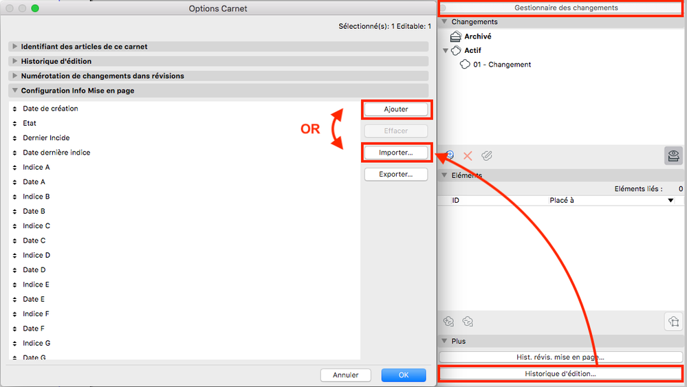

Like many other users, I don't use the Change and Review tool, so I had to find a system.
The solution I devised and adopted (since AC19) consists of creating new Layout information so that it can then be used as automatic text.
You can then create a table on a worksheet to place it on the layouts.
This was my first "simple" solution!
I then improved it by creating an object that requires creating a "dummy" change to display the table in the layout, but which automatically adapts according to the number of changes.
Here is a video presentation of the object in French (end of 2019).
I've attached the object (in French, but you can easily translate it) and the layout information that works with it and must be imported.
https://youtu.be/eBxdJlmtqME
https://youtu.be/KmnnubB9ErY
