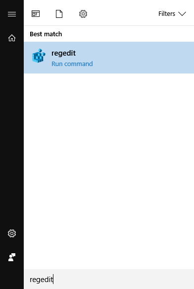

Step 1: Run Regedit
Click on the Start button and type regedit, the blue icon of the Run command will appear in the Best match field and press ENTER to open the Registry Editor:

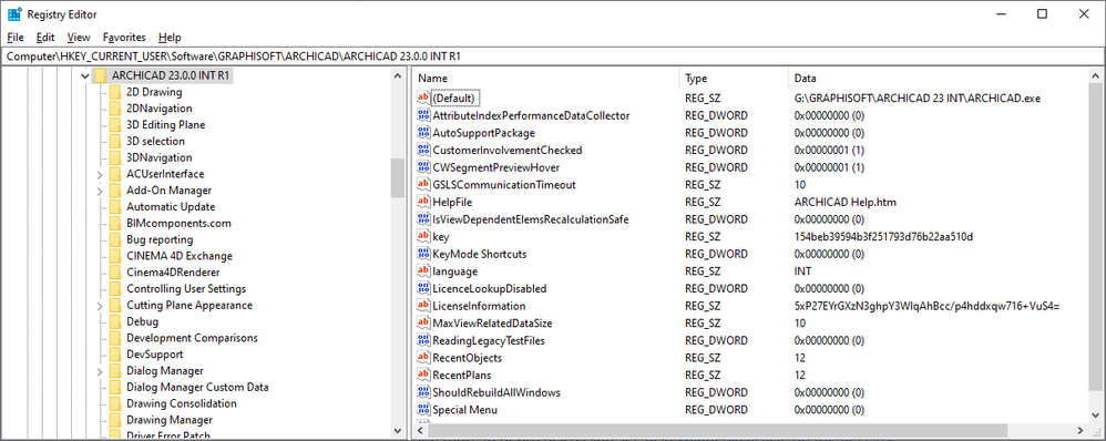

Step 2: Modify the Registry Key
The Registry Editor displays keys organized into folders. An important top most folder is called: HKEY_CURRENT_USER. The keys you might need to change for modifying ARCHICAD's behavior will be located under Software, and then under Graphisoft. Here you will find the keys used by all the installed ARCHICADs on your computer. You might even find keys for ARCHICAD versions that are no longer installed on the computer.
Here is an example of what you might see:
HKEY_CURRENT_USER/SOFTWARE/GRAPHISOFT/ARCHICAD-64/ARCHICAD-64 [version.0.0] INT R1

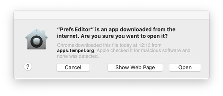

Upon starting the application for the first time, you might be presented with the following message:
Click Open and the application will start:

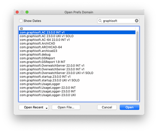

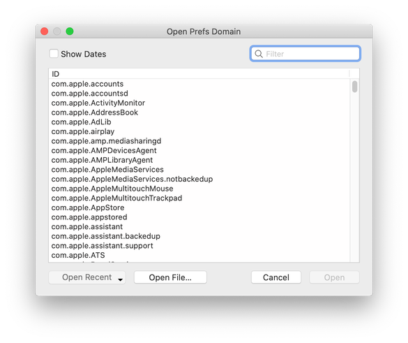

Prefs Editor will automatically list all PLIST files from the <current user>/Library/Preferences folder. Through the Filter field, you can look for the PLIST file to edit by typing in the name of the PLIST file.
