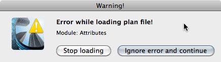

I can't get my recently downloaded version of ArchiCAD 10 to open my ArchiCAD 9 files. Is it because I am using it in demo mode? Any suggestions?

I just tried opening an AC 9 file with AC 10 in demo mode (no dongle) and it opened with the attached warning, but it did open. What is the problem when opening the file? And why are you using demo mode, this will not allow saving or copying.

Thanks for your reply. I am running in demo mode because I am currently taking an online course for architectural drafting to see if it might be a viable source of income for me. I have a student version of AC 9, but wanted to use the most updated version available for my system. The .pne files from version 9 are not recognized. ie. they are "greyed out" in appearance in the dialog box unless I change the drop down selection menu from "ArchiCAD files" to "all files." However, when I do make that change, I get this error message:

Your 'pne' file for 9 is an educational version file (vs professional 'pln'), and so that's likely the problem. The full version is supposed to be able to open EDU files, in educational mode ... but perhaps there is something unusual about opening an EDU file in demo mode.
What version of 10 did you download? Educational? Pro? Special 'file converter' download?
