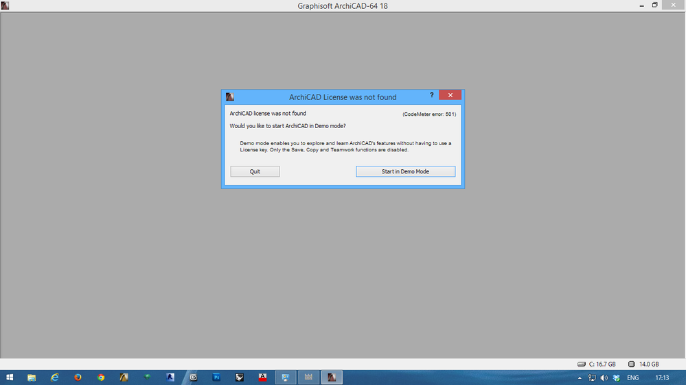

Installed ArchiCAD 18. Computer then rebooted without warning after what seems to be after installation (happened on every installation of ArchiCAD 18 ). After reboot ArchiCAD had been installed.
However it is only allowing me to use demo mode. Codemeter error: 501 (see screenshot attached)

I have always used the educational license. During installation it didn't ask me for upgrading keys or enter new serial which I have done in previous installations of ArchiCAD versions. I feel I have missed a step somewhere.
Ive also noticed there is a Codemeter Control Centre in my notification area. Anything to do with the 'Codemeter error 501'?

Thanks Barry for your suggestions. I forgot to mention the EDU version bit!
I tried opening a file saved in AC17 in AC18 but the same codemeter error dialogue box pops up.

I've solved it!
***MAKE SURE YOUR JAVA IS UP TO DATE BEFORE INSTALLATION***
I've installed both 64 bit and 32 bit JAVA Version 7 Update 65.
