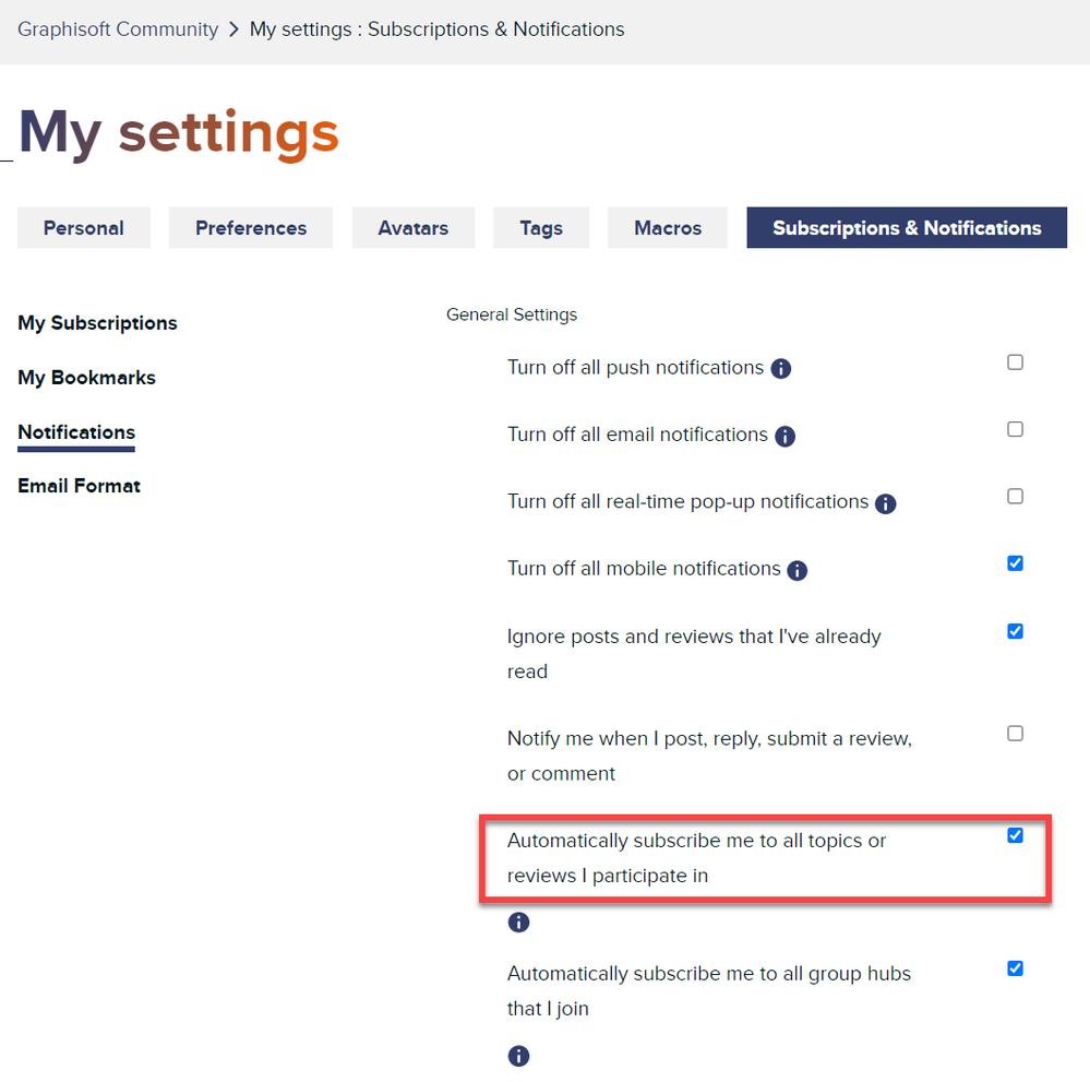

Go to the "My Settings > Subscriptions & Notifications" page, and select "Notifications" on the left.
Then you need to do two things.
1. Make sure the "Automatically subscribe me to all topics or reviews I participate in" checkbox is checked.
2. Lower on the page, under "Email Notifications", set the "New replies posted to content I subscribe to" field to "Immediately".
