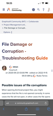

I keep trying to share a link to an article on the Community site here but it keeps being removed. If you search for ‘cannot open plan file’ an article will show up that was published by Graphisoft explaining methods to fix the issue.

https://community.graphisoft.com/t5/Project-Management-articles/File-Damage-or-Corruption-Troublesho...

This is the document/ page  A9C5A408-737C-410D-BFC9-464D8D45FA2E.png

It seems the system was automatically quarantining the post because of the link - I don't know why, and it shouldn't have.
I have released one of them so the link is now there.
