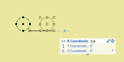

I usually set my units to Fractional Inches. When I try to move an element a fraction of an inch using the forward slash (i.e. 3/4) the input gets an undesired entry upon hitting the forward slash ("/"). This didn't happen in AC26. The glitch also happens on both Windows and macOS. To get the screenshot to show 3/4, I had to type /4 and then move cursor back to front and type the 3. It works and moves it 3/4", but I hate that solution. I can also use decimal (i.e. .75) but that isn't user friendly when inputting other fractions in decimal format. I hope this is an easy fix.

Can Confirm that if Units are set to Fractional Inches it typing / removes the first digit working as if Decimal Inches is selected.
This is a Bug in 27 introduced when they added math functions to the tracker.
The other bug is this one:
Initially during the Beta "/" after a digit was used for division, this was changed to "//" so that tipping "#/" would mean inches.
Except that it was not a complete fix, since it only works in some occasions and your use of fractions only might be showing more errors.
It took me a while to figure out what is wrong in 27 but basically the standard workflow for placing or starting to draw a specific distance (in inches) from a reference point has been:
  1. Place the checkmark on the reference point (do NOT move the temporary origin "x" to that point)
  2. Type X or Y depending on which axis you want to go in order to activate the tracker
  3. Type the distance followed by the / then +or- to select the direction.
  4. Hit return
In 27 this works as long as you are moving in the negative direction (down or to the left).
IE if you want to place an object 36" to the left of the reference checkmark you type:
  • X36/-
This one still works.
If you want to place it to the right by typing
  • X36/+
it will ignore the / and start 36 feet from the reference point.
  • If you type: X36"+ it works correctly. So does X36/-+
I wish there was an option to globally deactivate that "upgrade" and have the tracker work as it has for the last 20+ versions.
