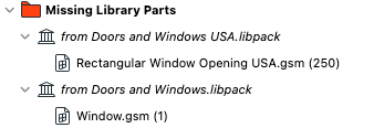

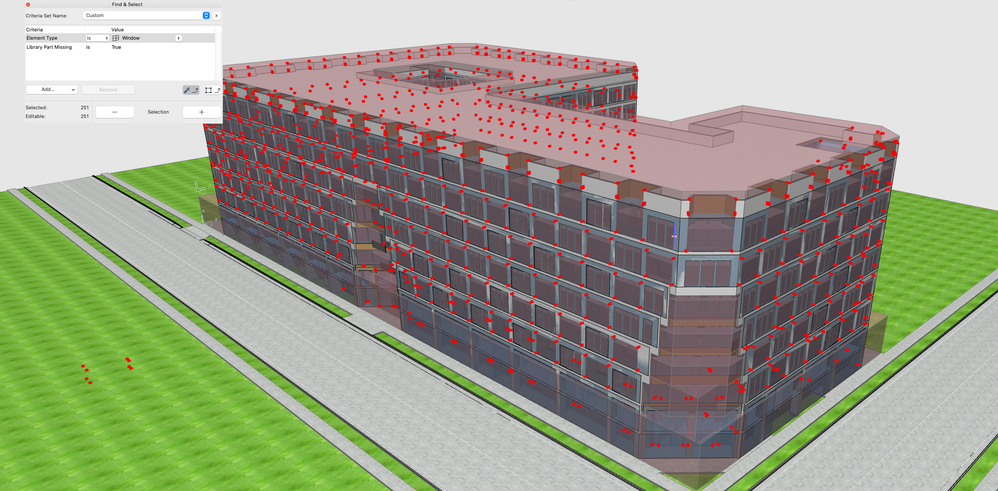

Update: We now have files with numerous objects missing, 250+, all with varying sizes and attributes. The time to repair is time that is not available. I'm not sure what changed with the library objects, as not all of them were affected. This will prevent future update consideration.

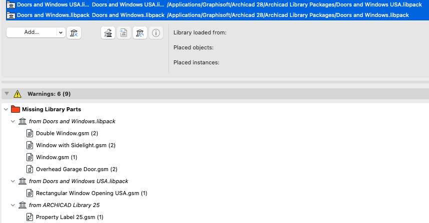

We are on Apple Silicon (latest MacBook Pro) and using the AC USA with the separate libraries. We only have one wrinkle from the standard, in that we added the windows and doors to the international library. The issue is with these two libraries.

I am wondering if you had previously installed the Global Library 2 update?
So, your worked on files will now have new updated objects (in particular the windows).
Then you had trouble installing the Archicad update and ended up re-installing Archicad.
This will only have library update 1 (the original library).
Then you have updated Archicad, but that will not update Archicad will not update the libraries as well.
I think all you may need to do is to re-install the lates Library update as well.
