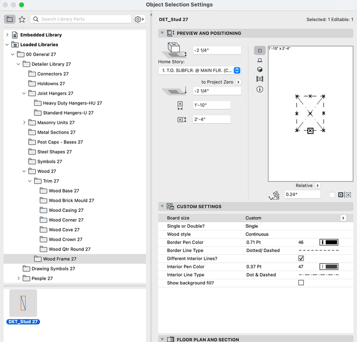

I'm just moving to a new computer and Archicad 28 and getting used to the Library Packs.  I've been able to locate and update most things, but what I can't seem to find are all of the 2D symbols that were in the Detailer Library as recently as AC 27.
Is there a Library Pack that I'm missing somewhere that I should be loading?  I've loaded all of the available Packs (minus some of the other language Annotation Packs).
I was able to find the Connectors folder under the Object Library/1. BASIC LIBRARY/1.7 2D elements, but I don't see the other symbols, i.e. Holdowns, Joist Hangars, etc.  Most importantly, I'm looking for the "DET_Stud 27" equivalent in these new Library Packs. I've attached a screenshot of it from the AC27 Library, if this sounds unfamiliar to anyone.
Thanks for any help,
Joel

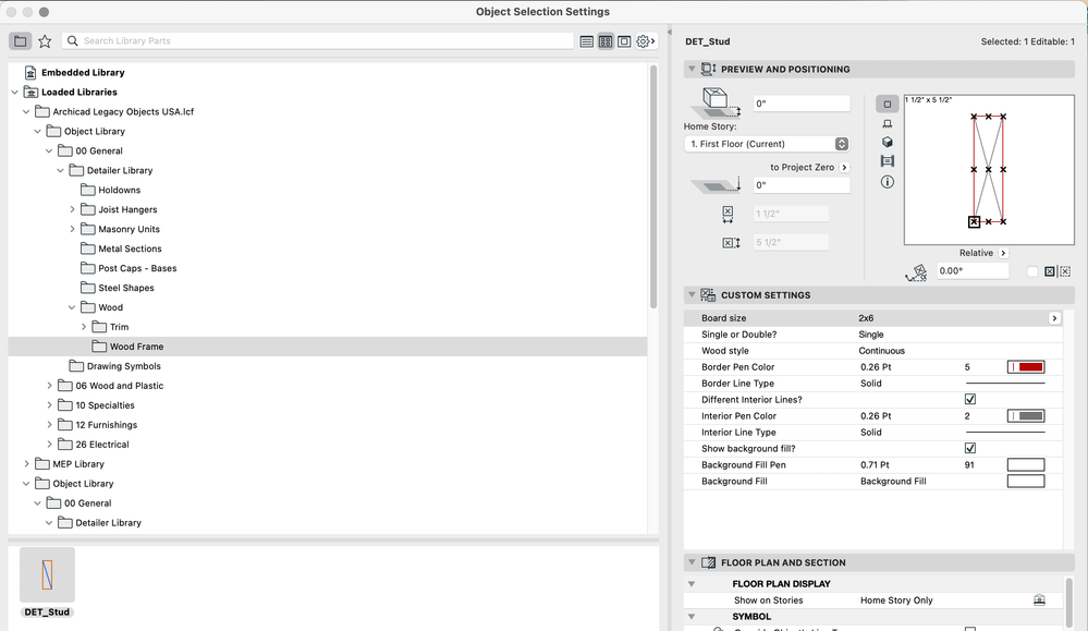

Joel:
I opened the AC default template, and the Objects are there in the Archicad Legacy Objects USA.lcf. In the Library Manager, it is under Archicad 28 > Archicad Legacy Objects.
David

Solution
David Maudlin
Rockstar
Joel:

David,
You da man!  Thank you, thank you, thank you, for finding that library!
It seemed a little strange to me that those objects were be completely eliminated when they were useful to some of us. Apparently, not many of us, but some.
I'm sure they'll be deprecated in the future, but I always thought they were a great tool for detailing.
Thank you again, Sir, SO MUCH.  Your efforts are of great service.
Joel
AC 6.5-28; macOS Tahoe; 2021 MacBook Pro M4 Max
