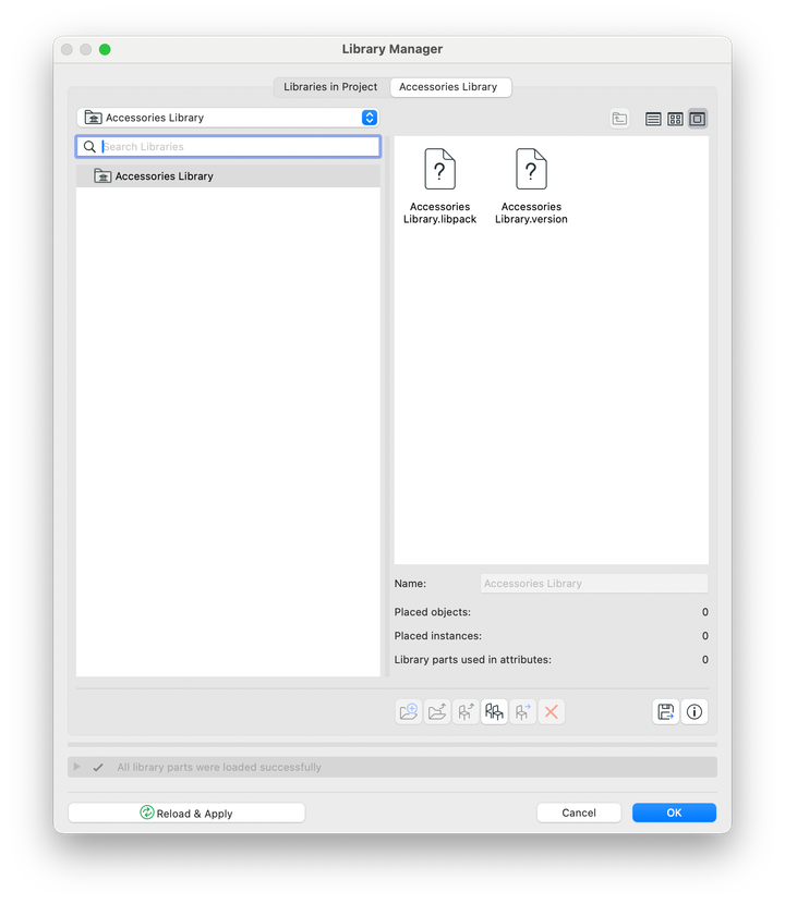

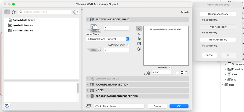

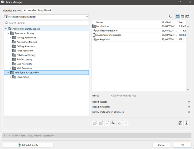

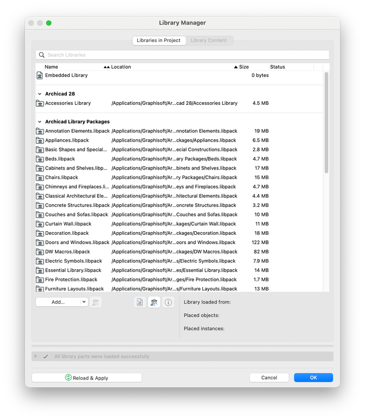

Graphisoft's Accessories library packages are not being recognized in Archicad 28 (refer to screenshot AC28_LibraryManager_Accessories), resulting in a prompt indicating that the requested accessories are not available in the loaded libraries when attempting to access ceiling, wall, or floor accessories, (refer to screenshot AC28_Accessories_NotWorking).
Could someone please clarify what I am missing?

You have loaded the 'Accessories' folder.
It doesn't work that way now.
You have to browse for the actual '.libpack' file and load that.
