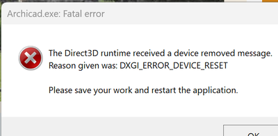

Archicad 28 is constantly freezing or crashing, diving a Direct3D / graphics card error.
Archicad 27 and Archicad 26 do not have the same problem.
I've updated graphics drivers, and uninstalled / reinstalled Archicad to no avail.
I get the same error every time; sometimes, it's within seconds of opening the program. Other times, it can take several minutes. But it happens multiple times a day.
'Direct3D Runtime received a Device Removed Message  DXGI_ERROR_DEVICE_HUNG'
That's typically an issue with either the graphics card itself or the graphics card's connection the rest of the machine. However, this is the *only* program experiencing the problem, which is usually indicative of a glitch in the program or an incompatibility between the program and the graphics drivers.
These are two of the smallest projects I've ever done in Archicad, and the only two on 28 so far. Archicad 28 appears to be sending conflicting instructions to the GPU, which causes it to hang. No other programs are effected when it happens; in some instances, when it happens in one Archicad 28 file, it doesn't even impact the *other* Archicad 28 file I've got open.
Dell XPS 15 9530 with NVIDIA GeForce RTX 4060 Laptop GPU.

Got a response from GS (or NVDIA).
The suggest to uninstall the driver by using this tool CleanupTool_1.0.20.0.exe, restart the PC, reinstall the driver by selecting "reinstall". If that does not help, we should reinstall Windows.
Apparently (according to YouTubers like GamersNexus) NVIDIA currently has massive driver issues.

576.02 Studio Driver just dropped with over 40 bug fixes. Maybe give it a try.
Frank Schlenke
Still no Solution for this Bug?
WIN11; i9-13900KF; 32GB DDR5-6000; 2TB SSD; RTX 4070ti
Subsequent NVIDIA updates appear to have solved it for me.
That, and I disabled background updates for sections for now. When I re-enabled it, I got the error *once*.
