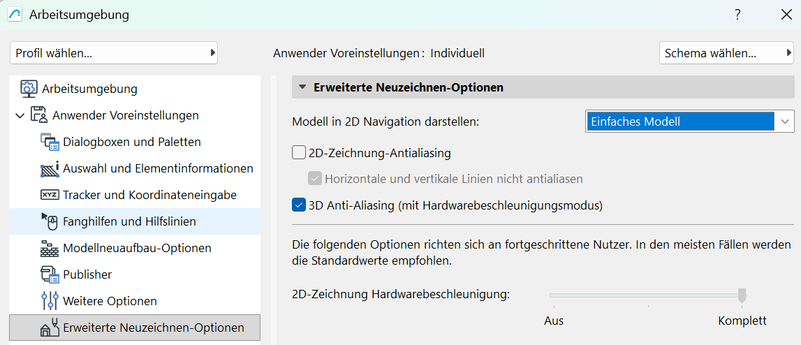

This is still an issue for us on Archicad 28 and 29 GER, Windows 11, NVIDIA desktop graphics cards. Occurs with design options but sometimes also without them when Archicad is running in background. It's always Archicad that crashes.
What helped reduce the issue was setting 2D-Navigation to "simple model" so fills are not being shown when navigating:
