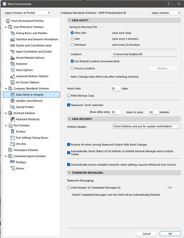

ivarheggheim
its still slow with the last hotfix 28.3.3.
I don't think it is the list of recent documents itself.
I think it is the preview images that are saved for every recent document.
These images only show in the start dialogue and there can be a number of images for each file.
Clearing the preferences clears these images.
Then pasting back the recent file list works and it will seem fast again.
Until you start opening those files and it builds up the images again.
I find you don't even have to save the file for those images to be created.
Just open the file from the list and it seems to take random screen shots of what you are working on.
I have worked on a file (just playing around in my template) and deliberately not saved it, but those images of what I was doing are in the start dialogue.
ivarheggheim
It would be nice then If we could have a setting in Work Enviroment under Data & Security or somewhere else, where we could turn off preveiws and a perhaps a button to purge these screenshots.
