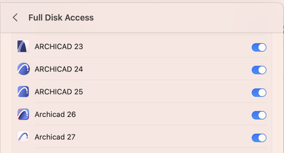

ArchiCad v25 will not open.  I have a constant 'Cannot create temporary documents' come up and then ArchiCad shuts itself down.  I work on a MacBookPro.  How can I rectify this so ArchiCad opens and I can access my files??!!  Thanks.

You did not read and follow the prompts near the end of installation,,,, you must go into system settings and give Archicad disk disk access,

Hi Karl, I've been working in this archicad for over 12 months with no issues.  This is the first it's come up on Friday.  Are you suggesting I uninstall and reinstall?
No, I'm suggesting you go to your System Preferences and verify that Archicad 25 has full disk access 🙂 Something must have disabled it... or otherwise there is some system issue going on...

Worst case scenario, uninstall/reinstall... or contact support 🙂
