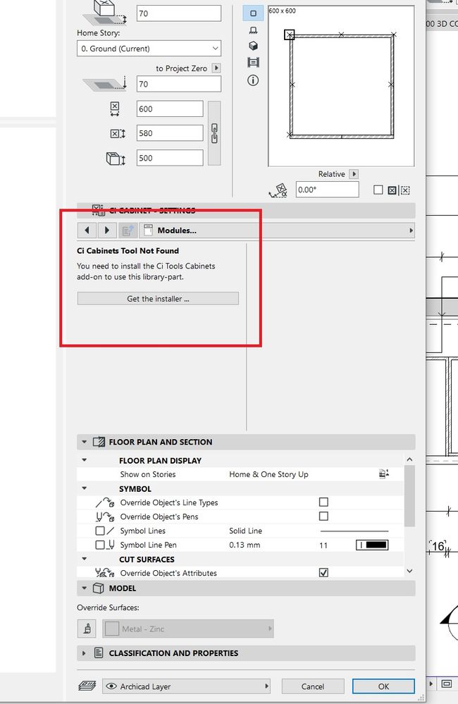

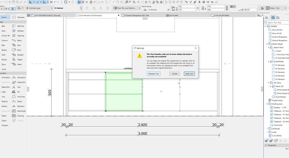

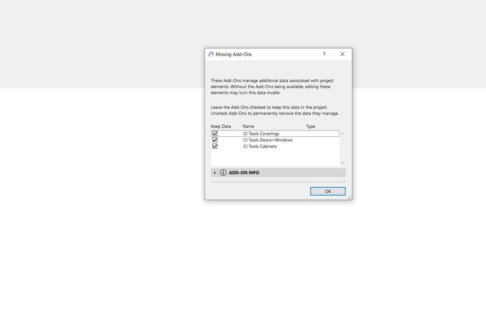

Since updating CI Tools on my comupter, it no longer works at all. Tried uninstalling and reinstalling. Just broken. Pretty pathetic since I asked them to add some features last year which they never did, and instead "updated" the software to make it stop working on my system. Can't finish any of my work now. Yay.

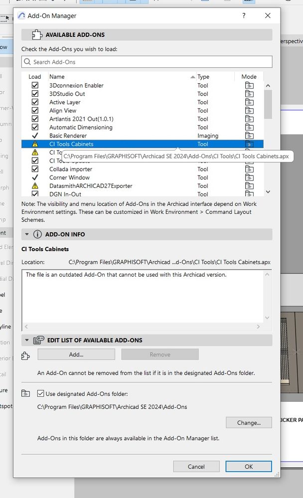

It’s likely due to this known outage.
you will need to update to the later version of the add ons to rectify.

Not only did I fully update the Add-ons, but I even resetted the settings in the Ci-Tools updater, and reinstalled the entire thing.
Online a possiblility I've been given is:
Possible Start Edition Limitation
Because you're using Start Edition, some add-ons compiled for the full version of Archicad by Graphisoft may not load even if installed.
If that's the case, the plugin developer must provide a Start Edition compatible build.
That's purely speculative but what else could be the problem? Everything I have is upto date.
