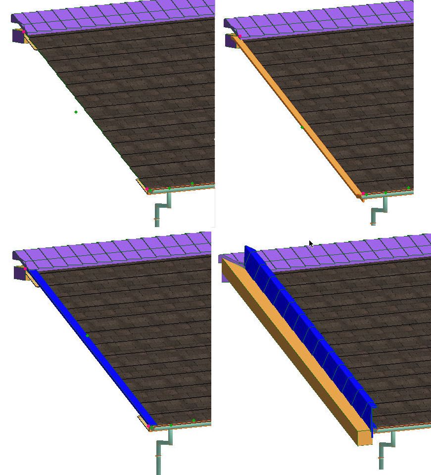

Using the Cadimage Accessories Tools add on for AC9.0, we are experiencing an issue that we can't find in the user's manual and are unable to resolve. Please see attached image.
When using the roof tool set to shingles, the edge tile (rake) raise up proportionate to the width of the barge board. Further, instead of the barge board extending towards the wall when set, it extends further out away from the rake side of the building causing the edge tile to fall within the board and not lap over the board normally.
Can someone knowledgable in the use of this add-on please advise me how the settings should be to correct this issue? Thank you for any comments.

can you send me a screen shot of the objects settings windows? what happens if you change the edge type in the 3D window? do you have the latest version (9.0.5)?
Please see the attached image.

it seems to be a problem with the barge flashing position and size. i don't get the problem you do with the 'ridge' flashing though . . . i think reporting it is the best direction.

Please see the attached to clarify how the edge should work.

Scott try playing around with the "Fascia & Barge Drop" fields, i have had issues and these seem to fix my problems.
Also try changing the fascia type from timber to metal this may help as they code each one seperatly.
Good Luck
Nuge
PS there is an update 9.0.5 issued on 25-10-05 sorry but its not on the Cadimage store site.
