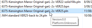

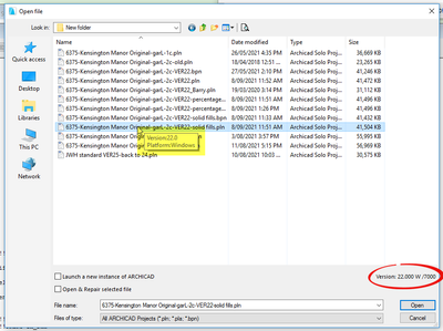

Try hovering the mouse over the file name in your Windows Explorer.
That usually give a pop-out that shows the file version.
Or open Archicad and use the FILE > Open dialogue.
At the bottom right side you will see the file version if it is the same or older than the version of Archicad you have open.
If you select a newer file, then it will show nothing if that is the first file you select, but will show the version of the previous file if you have selected another file first.
So this is not fool proof.
Also there you can hover over the file and you will see the version.
If it says version 0.0, then it is a file that belongs to an newer version.
