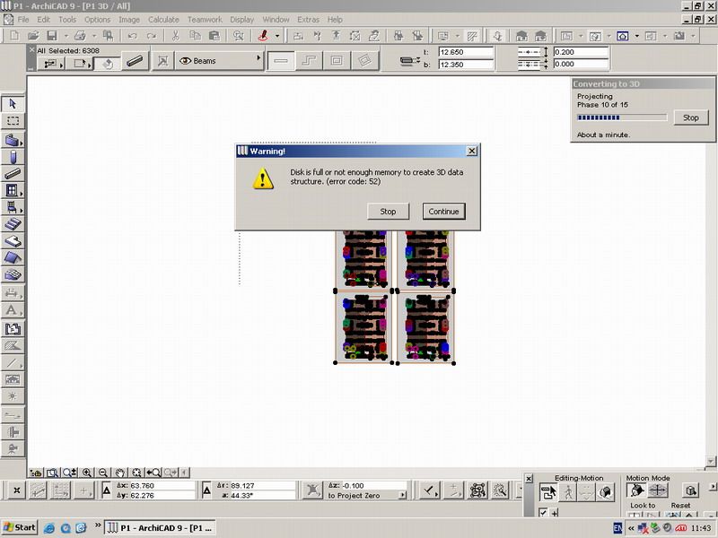

It can't render my condominium. And show Warning Box
" Disk is full or not enough memory to create 3D data structure.(error code:52)
Please advise.

Based on the description of your computer it certainly doesn't seem like you should be having this kind of problem; unless the hard disk is partitioned and the temporary and cache folders are on a partition that has very little free space.
If your hard disk is partitioned, go to Options/Work Environment/User Preference Schemes/Special Folders to find out where the Temporary and Cache folders are located and check to make sure there is free space available.
