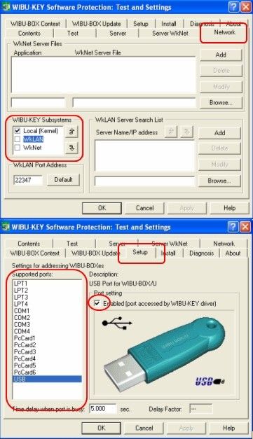

Another way to speed up ArchiCAD's start up is to control where it looks for the hardware key. On the PC (they've changed this on the Mac and I'll have to look for it when I get to my Mac) open the WIBU-KEY in the control panel.
On the Network tab, if you have a key attached directly to your computer you can tell ArchiCAD not to look over the network for the key, which it seems is always the first place it looks (see picture)
On the Setup tab, you can tell ArchiCAD where to look when the key is attached to you computer. In the picture below we are telling ArchiCAD to look at the USB ports; all others have been disabled.
Thanks for the tip
Thanks Ben and Woodster.
I have disabled virtual printer through registr.,
and changed WIBU Key.
It takes about 15 sec., till AC asks the next action.
