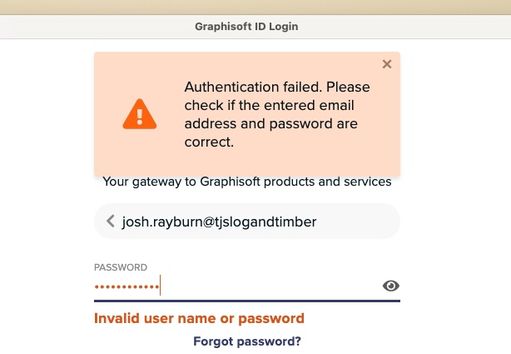

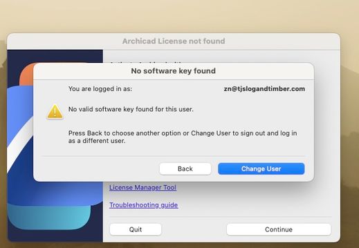

hi Karl - so downloaded and all went well however this is the message i get after selecting commercial software key for my username and josh. josh is the one who setup the subscription which should be transferred over on my end. had similar issue when i first started using ac27 but Steve helped out. not sure if i need to place a ticket with support elsewhere?ac26-a.jpgac26-b.jpg

It looks like you’re in the US, so you need to contact Graphisoft North America technical support to resolve that…assuming you do have a soft license no not a physical Codemeter USB key plug.
