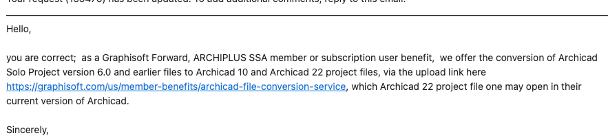

thanks to the both of you! trying to get answers with Graphisoft on whether we qualify based on...

Zdenko
just passing information to anyone who needs to know...
