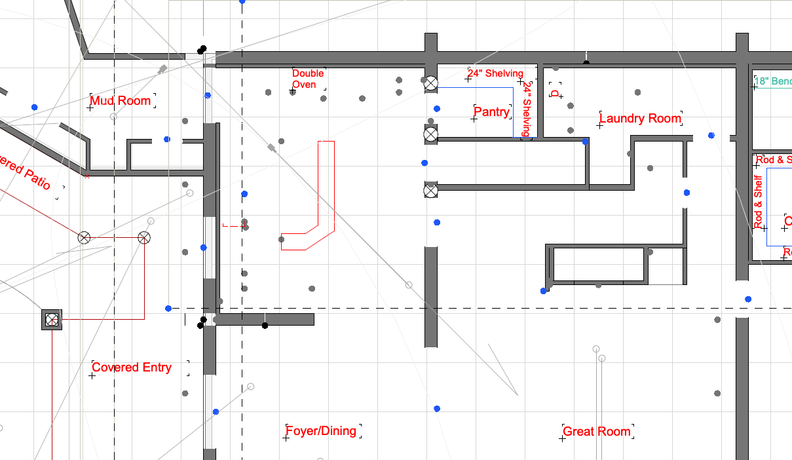

hi Karl - looks like we resolved the license issue with an update to AC26. we can open the files however the object libraries, as you mentioned earlier, are not coming in. any suggestions?

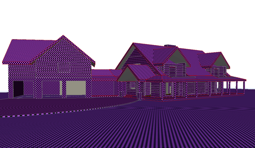

the 3d is pretty wild 😀

Concerning the libraries ... yes, the libraries are binary identical between Windows and Mac, so it doesn't matter what kind of old computer they had ... even if you only have access to a backup disk ... the library folder can be used to open the old files... and then save as PLA in the new format.  You do not need any other folders other than the library folder... and could copy all of them into one big "Legacy Libraries" folder where you can easily find the one that you need.
This color indicates that the textures are missing. Use the Surfaces dialog box to assign the desired textures to the Surfaces.

But you’ll see that his windows and doors are missing too… so he needs the whole library to migrate the ancient file…textures and objects 😊
