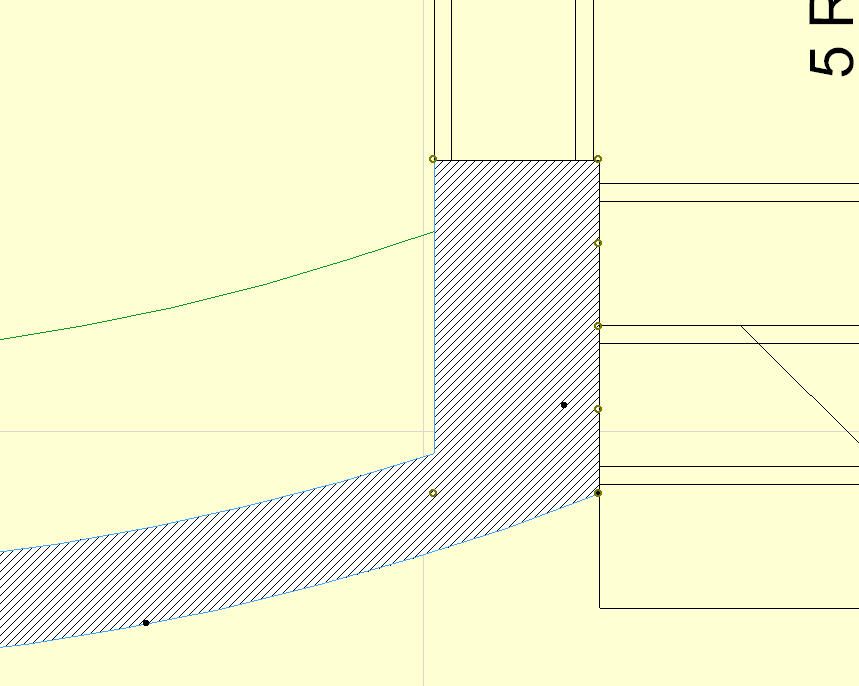

I searched for this issue without luck. In plan view, a curved wall properly intersects and joins another wall. The other wall has been trimmed to roof. When projected, the walls do not join (however they will join in 3d if the second wall is not trimmed to roof). Is this a known issue or am I messed up? Thanks.

The problem revealed itself. We inadvertantly had an extra roof touching the curving wall causing the intersection to misbehave. I'm sorry for any inconvenience.
