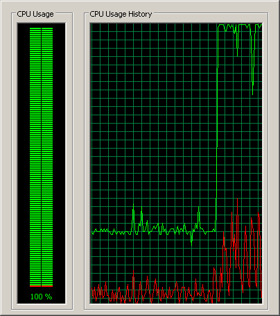

I work with the U.S. Corps of Engineers in the Tech Support Branch. We have a user using ArchiCAD 9.0 build 2045 His system has 3 GIG of memory... 2- 3.6 GHZ processors.. it seems when he generates fly-thrus. The CPU usage is only around 25% on one CPU and less on the second.. If we move the process priority to above normal, the first CPU goes to 100% and the second is less than 20%. I would think this would load balance better. This is running on a Windows XP SP2. Any thoughts would be greatly appricated... Thanks, Dave.

Archicad is not optimized for multiple processors.

Sounds like you've already got a fast machine with a boatload of RAM. That's about it.
We're doing fly-throughts on Cinema 4D, which can use our 30 Mac G5 machines as a render farm. Single machines took too long for anything higher than screen resolution or more than several seconds long.
Tom Waltz
As far as I know, the only time ArchiCAD uses the two processors is when you are using the LightWorks rendering engine.
Otherwise that's about the fastest you can go.
I don't know if using fast SCSI drives would make any significant, perceiveable difference. It might.
