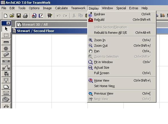

One niggling thing i have with archicad is the maneuverability. Is there a fast way to pan and to zoom or do i have to keep selecting the option with the mouse? I like to work with the keyboard and mouse at the same time, its faster.. ?

BryanRichards wrote:
.. Is there a fast way to pan and to zoom or do i have to keep selecting the option with the mouse? I like to work with the keyboard and mouse at the same time, its faster.. ?
Bryan, In AC7 click on the Display Pulldown and you will see a list of the zoom commands with their associative keyboard commands. (ie. On PC, "Zoom In" is the Ctrl key with the " / " key And the "Fit to Window" (Zoom all) is the Ctrl key with the " ' " key.)
Hope that helps (HTH)
ahh, that works for me
Wish there were two control buttons on a lap top but now im just being fussy thanks
