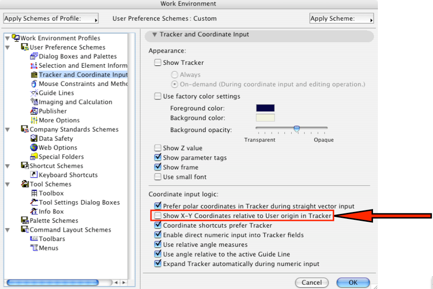

TomWaltz
Turn this off:
Tom Waltz
archislave
Thanks, Tom, but it was already unchecked. Like I say it will work only one when the file is open. Maybe something with a plist in OSX ... I have no idea. My reseller did not know.
