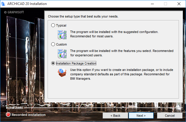

15. Choose Setup Type
To prepare for Network installation, choose the option for Installation Package Creation.
The screens of the Installation Wizard will now show the message “Recorded Installation.”

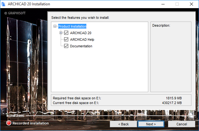

16. Choose Program Components
Select the features you wish to install.
After you make your choice, click Next.

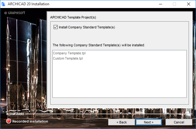

19. Install Company Standard Template(s)
Check this box to include your saved Template in the Installation Package.
