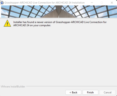

I´m having a problem with the Archicad Grasshopper Live connection in my computer. My office currently uses AC24 and I need to make a project using GH.
I was having the AC 24 bug that a lot of random words appeared in the plugin. I was able to fix it updating my AC24. But since I was working with teamwork I had to unistall and install a older version of AC so I wasn´t blocking my other collegues to join the project. Now I´m back in the latest version of Archicad but I keep on getting this warning from the AC GH live connection installer
I have already uninstalled everything and downloaded the latest upadate from the Graphisoft webpage but nothing seems to work and I have no ideia of what is happening.
Please help me figure this out so I can continue to work in this project 🙂

Hi Rodrigo,
Thank you for your query. I did a bit of research on your case and I am afraid it will need further investigation, analysis of the logs on the C:\ProgramData\Install.GS folder. I recommend you reach out to your local technical support. Based on your name, I supposed you are in Brazil.
You can reach support via this link.

Solution
Hi Rubia,
Thank you for the reply, I manege to figure out a solution. I had to restore my notebook before I reinstalled AC24 to a prior version.
Best regards from Brazil!

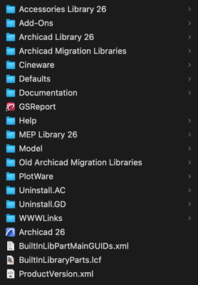

I don't see an Uninstall.GC folder, I have Uninstall.AC and Uninstall.GD (which I assume stands for the Goodies):
odv.hu | actively using: AC26-28 INT/HUN - multiple builds | Rhino6-8 latest build | macOS @ apple silicon / win10 x64
Hi @furtonb,
In this case, please contact your local technical support. We recommend you send the /Users/Shared/Install.GS folder content to the team (installer log files) for further investigation. They should point where the software has found another version of the Grasshopper-Archicad Connection.
