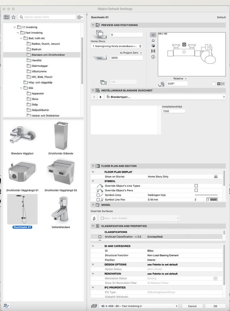

I'm having a problem with the Swedish version of archicad and the Library update 2.
The Shower Kit object doesn't allow me choose any Style than the preset one, the space is empty. This only happens on the Swedish version of Archicad and not on the INT version.
Is the same for PC and Mac.
Other question is where can I report a Bug directly? Couldn't find any link on the Grapfisoft website.
Operating system used: Mac Apple Silicon Sonoma 14.2

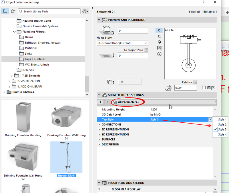

If you change to 'all parameters' tab, can you change the style there?
Looks like it is just a graphical interface problem.

Exactly what object are you using?
As far as I know with the Global Libraries, it is exactly the same shower in all language versions, it will just be in each individual language.
Is it this one?
This is the object. It's called Shower Kit 01 in the INT version.
I try to copy the INT version object to the SWE version and doesn't solve the problem. I comes with the correct Style but the menu is empty as in the image.
Solution
I just set my template to use Swedish localisation preferences, and the interface selection does disappear.
So it is definitely a problem with the Swedish localisation of the library.
And if it has only happened since library update 2, then it is an issue with that update
You will need to report this to your local Archicad support.
I will move this post back to the 'Installation & Update' forum, as that is what it seems to be caused by - not the library object itself.
