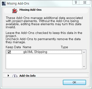

hello
I was making TPL file than run TPL file.
This message was appeared when TPL file was just started.
I did't install any add-ons.
Why this message was appeared?
I am attaching image file.

DEUKWON wrote:
This message was appeared when TPL file was just started. I did't install any add-ons.
That's one of our add-ons (to export gbXML to IES, DesignBuilder, Ecotect, etc). Someone must have trialled the gbXML add-on at some stage, or perhaps the template is based on a project received from someone else who uses the add-on. I suggest starting a new project from the template, unchecking the box to retain data from the add-on, and saving as a template again. Then you won't see this message again.
As a request to GS - does this message really have to be displayed to users every time? Couldn't the process of reviewing the data held by add-ons be bundled into the Add-On Manager?
