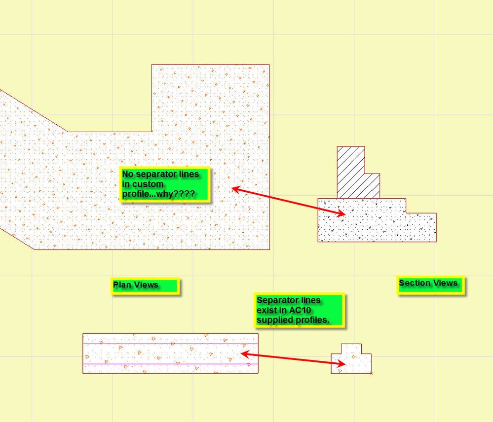

Hello friends,
In the attached image the settings are the same for each Complex Wall. The only difference is that one was custom made from a fill and the other is a standard Complex Wall Profile that came with AC10. Please note that the separator lines are missing from the custom created profile. Is this a bug or am I missing something?
Thanks,
Scott

Creating the complex profile elements can be, well, complex. I am still getting used to all the various possibilities, so I don't have a quick answer for you. I am having no trouble getting the separator lines to show up, etc. Try fooling around with the editor. The "Profile Uniform Colors" might do the trick for you. Use the "Override" button to apply the settings.

Thanks for the thoughts. I have tried all your suggestions still without luck. Have you tried making a custom profile complex wall from fills, and have the separation lines display properly in plan view? I'm leaning toward bug as there also seem to be some strange things in the complex wall settings DB. Please see attached.

Have you played with all of your plan view controls? Projected, symbolic etc and looked at your cut plane?
I think Mike is right. The plan view controls for the wall are the key. Unfortunately, the possibilities are almost endless which makes the whole process of making your plan view look "correct" a huge chore in AC 10.
In addition, the elevation of your wall relative to the cut plane has an effect on the way these plan view controls work. It quickly becomes very confusing.

Excellent info. In my test profiles with 'Projected w. Overhead' and 'Show Entire Element' selected, the plan display properly shows the cut portion of the wall, and some but not all of the projected lines down, but does not show any overhead lines above. Also note the irregularities in my screenshot of the Wall Settings DB from an earlier post.
Yes, in every possible combo.
Please see attached example of settings and resulting unexpected display.
