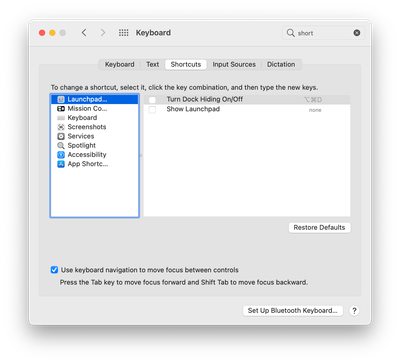

Go to System Preferences / Keyboard / Shortcuts, then under Launchpad untick "Turn Dock Hiding On/Off".

Just go to System preferences -> Keyboard, click on the shortcuts tab and then click on the alt-cmd-D. It will highlight.
Digit the shortcut you want.
That's it!
