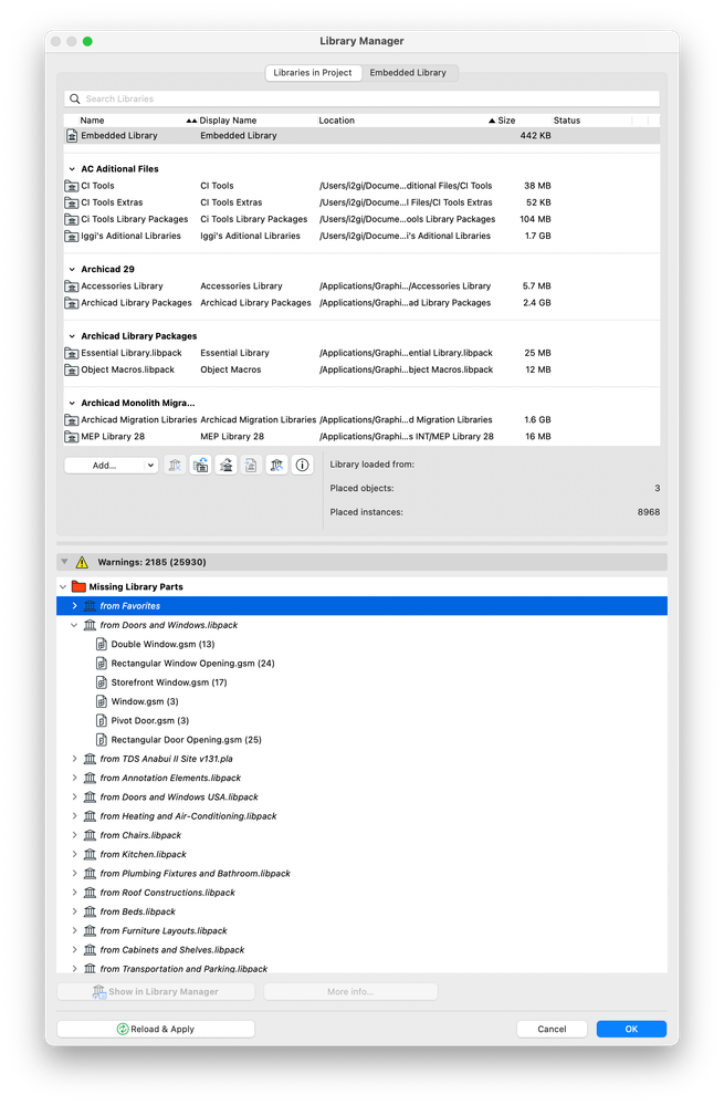

I’m having a bit of trouble with the work moment because I don’t have time to give my presentation. I’ve upgraded to version 29.1.0, but my libraries are missing. I thought I’d uploaded everything, but I still have over 2,100 missing libraries. Is there a way to see which libraries are missing?

I think this is the issue: your library packages are loaded from their source folder; they need to be loaded separately.
Archicad does not recognize libpacks that are linked from their source folder... it's a weird "design feature".
try removing this folder, and adding all contents FROM that folder directly:

also, if you were using anything from an old .lcf library, you may need to extract some of the things still missing and add them in individually. I have fully extracted markers and detail library (2d object) parts that were either not in the .libpacks, or not able to connect to the new part/location within the libpacks.

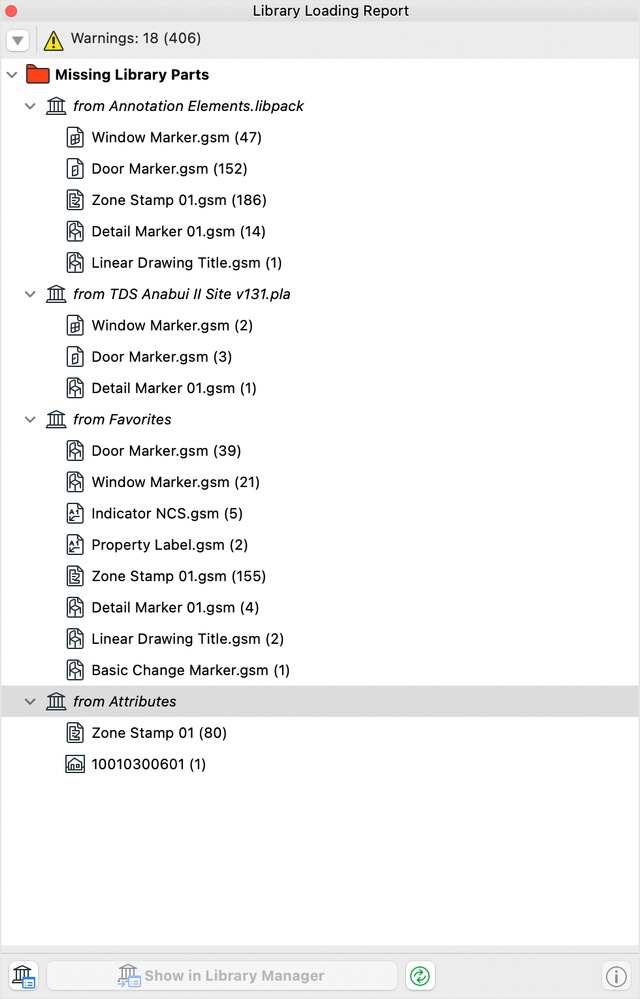

I was so close to a meltdown! But I think I’ve cracked it. I opened the Graphisoft full “Archicad Library Package” from the folder. Then, I deleted the old version and brought in all the package contents from the folder. That did the trick! Now, I just need to tweak a few missing markers. There are 18 missing out of the 408 markers used in the plan. I’m not sure how to fix this, but at least I can keep working.

Changing the Zoning Stamp was easy! I just needed to go into the Attribute Manager and change the default setting. But, it’s a bit different with the D&W stamps. I’ve do not have the D&W marker I had before. Does anyone know where they could be store?
