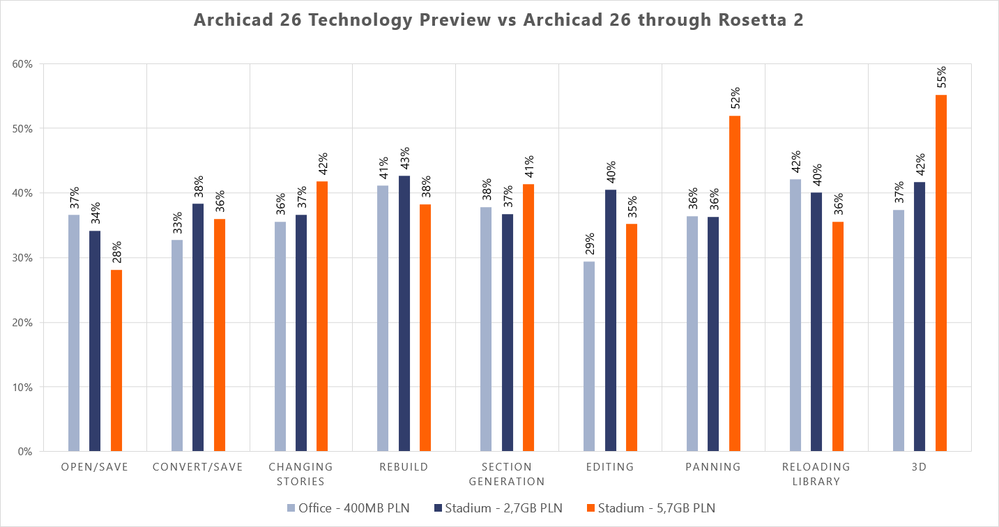

The graphs below show the performance improvements obtained during the tests, with results in the range of 28 to 55% increase in speed (baselines values from Archicad 26 3001 running through Rosetta 2)
