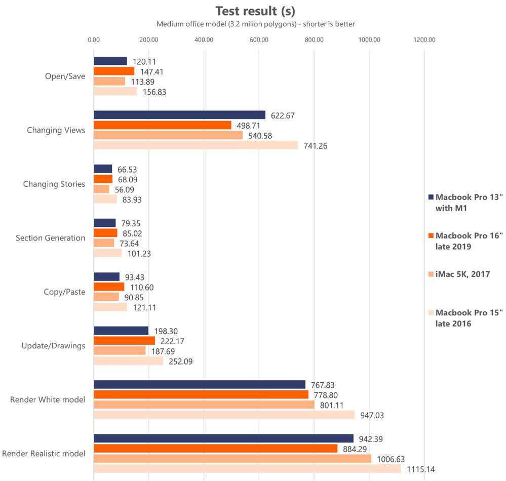

Archicad uses the CPU for most operations (like Processing Elements, Generating 2D Views, Rendering). We performed the same sets of tests to compare the performance of M1 with various Intel-based Macs: the late-2019 Macbook Pro 16", the iMac 5K in 2017, and the late-2016 Macbook Pro 15". Their specifications can be found below:
  Macbook Pro 13" Macbook Pro 16", late 2019 iMac 5K, 2017 Macbook Pro 15", late 2016
CPU M1 9th Gen Intel Core i7 2.6 GHz (6-core) 7th Gen Intel Core i7 4.2 GHz (4-core) 6th Gen Intel Core i7 2.7 GHz (4-core)
RAM 8GB of Unified memory 32GB 32GB 16GB
HDD 512GB SSD 1TB SSD 512GB SSD 512GB SSD
GPU Integrated Graphics AMD Radeon PRO 5500M with 4GB of GDDR6 memory AMD Radeon Pro 580 with 8GB of GDDR5 memory AMD Radeon PRO 460 with 4GB of GDDR5 memory
The results from our tests are quite positive:
*The tests are performed with Archicad 24 Update Preview 4000

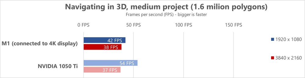

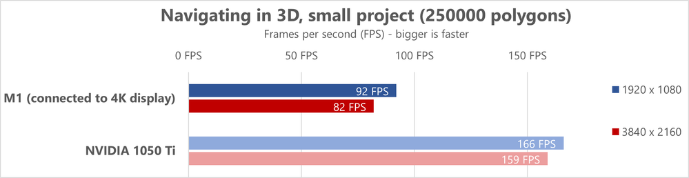

The graphics solution is integrated into the M1 processor. Official information from Apple suggests that the M1's eight-core GPU can simultaneously handle nearly 25,000 threads and deliver up to 2.6 teraflops. This puts the M1 on the same level as Nvidia GeForce GTX 1050 Ti or the AMD Radeon RX 560. In our Archicad 3D navigation tests, although M1 registers a slower result, it still provides smooth navigation.
*The tests are performed with Archicad 23 Update Preview 6000
