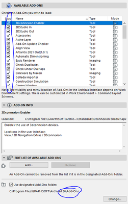

After few hours of frustration. I simply just go to Options>Add-On Manager,
then deselect all add-ons and press Ok > Save Changer and Reload Project.
When program restart,
Select all add-ons and press Ok > Save Changer and Reload Project.
Program will restart again and your goodies will be uploaded.
