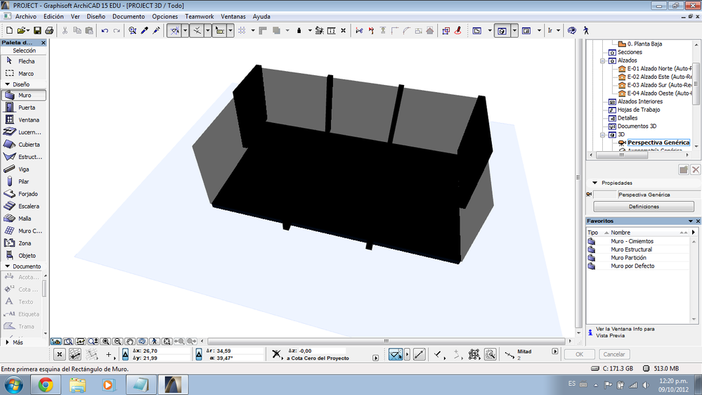

Hello, my name is Bianca and I wanted to know if someone can help me with this problem I have. I can draw perfectly but, when I switch to 3D view I can't see anything because all the elements I drew are black or grey, the materials which they are made of don't appear! Everything is just black and grey. And I have this big presentation next week and I don't know what to do anymore! I tried reinstalling the program and everything, but nothing happened. Please help me!

Check your Renovation Filter for the 3D window. It may be that the renovation overrides (in Renovation Filter Options) are changing the material.
And your English is perfect.
Thank you so much, but nothing happened
What happens when you start a new project with New & Reset and copy-paste this model into it?
Nothing , still the same.. My teacher of CAD at school told me that perhaps it was a problem with the video card.. but I how do I know if the card is incompatible?
Then you can try to upgrade to the latest driver of the graphics card and see if that changes anything.
