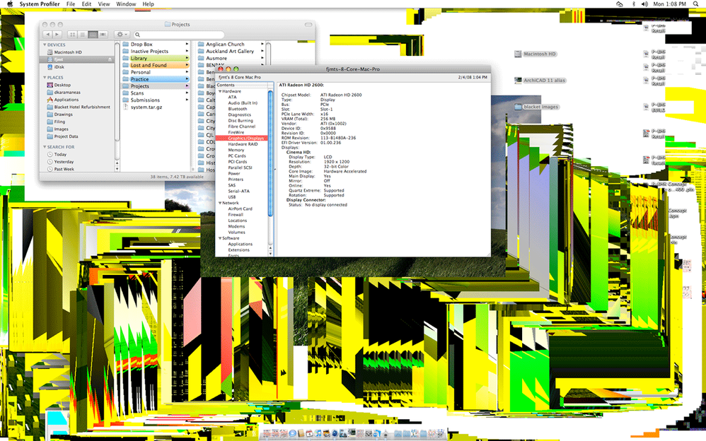

Problems with Video Display on a new Aluminum iMac
I have had this happen on two different IMacs and only when we run AC 11.
It seems to be triggered by Itunes running at the same time.
Has anyone else witnessed this before? Any suggestions?

Now i have.
We have just started receiving the new 8-Core Mac Pros with the standard ATI Radeon HD 2600 card (pretty much the same card as the iMac has). Every single one of them (5 so far i think) is displaying this behaviour. It seems to be triggered by ArchiCAD but once it occurs it persists in all applications until a restart even if ArchiCAD is closed.
Our supplier even replaced the cards - no luck. We are now trying to get a replacement nVidia 8800 GT but there is a few weeks wait apparently.

Not limited to Alum iMacs, I had it happen my previous generation (white) iMac last week. If we are lucky it is a video driver, leopard, AC issue that might be fixed with 10.5.2.
Eduardo Rolón AIA NCARB
AC29 US/INT -> AC08
This seems to be a serious problem with ATI cards in Leopard. I have been having this problem on my MacBook Pro (ATI X1600) since I upgraded to Leopard. It only comes up after a full day's work. This fact and other reports I've seen suggest that it is related to heat buildup. It also appears sooner when I am plugged into a 30" monitor. It also got better last Fall after the weather cooled off, and when I am plugged into the big display it improves when I put the laptop up on blocks for better airflow.
I don't think it is specific to ArchiCAD but rather seems to be an Apple/ATI problem. The fact that it always seems to appear when we are using ArchiCAD (I think) is because it is a demanding program and it is what we here on the ArchiCAD forum use to make our livings. I suspect that someone cranking along all day on another similarly demanding program will experience the same results.
For now the only solutions seem to be to switch to NVidia cards for those who can, and to try to keep the machine cool for those who can't.

drh64
They are replacing my graphics card AND my power supply on my 24". The tech said that the machine is running way too hot. While using my 20" as a backup this week, I had the same problem occur once. So, it does seem to be related to a software or standard hardware configuration.
owen
The fact that this problem is heat related is understandable (not excusable) with the enclosure of the iMac but a real worry given the Mac Pros are certainly not lacking for airflow.
This problem really shouldn't be happening .. the main benefit of the Apple closed system is everything they sell should have been thoroughly tested before going to market. I would certainly count pushing a Mac Pro to its limits for days on end as part of this process.
