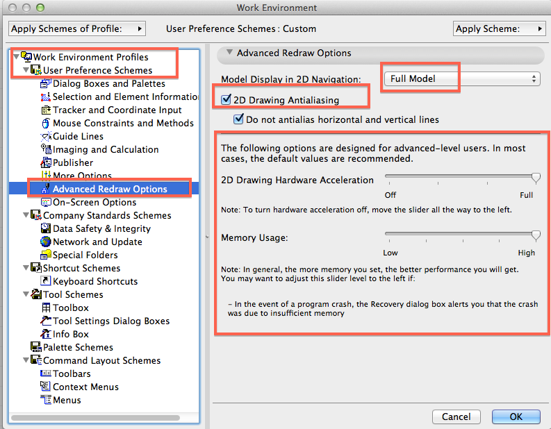

Laptops mostly come with whatever graphics they come with - you usually cannot install / change the card - it is more a matter of purchasing the correct laptop in the first place, unfortunately.
Attached are some screenshots showing where you can change the graphics usage of ArchiCAD. First, with this post, is the Work Environment setting panel for 2D navigation in case any of your freezing has happened there.
If freezing in 2D, try lowering many of the settings - instead of Full Model for the display during navigation, try the next option down. Uncheck antialiasing.
I would guess (?) that you should still keep hardware acceleration on Full and memory usage at High, but you can always try sliding both all the way to the left to see what happens?
See also this article:
http://www.archicadwiki.com/2dSpeed
