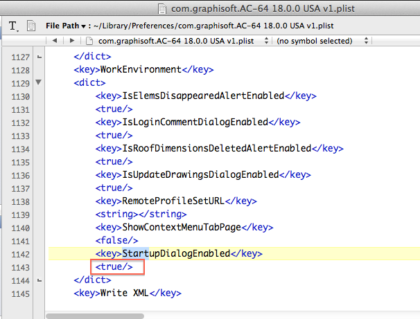

If you want to get the dialog back without changing anything else that a New & Reset does (I'm not really sure of how many things that changes) ... there is a plist item you can change to 'YES' if you want to get down and dirty... see attached. For Windows folks, I assume there is a similar Registry setting...
The plist is in ~/Library/Preferences ... screenshot is the Xcode editor.

Here's a text editor view of the plist XML file, search for the word 'Startup'. Yours will show "<false/> where my screenshot shows <true/>. Just change it/save.

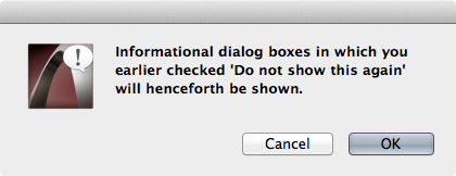

Aaron:
Go to your Work Environment and add the command Enable All Informational Messages..., this will bring back all the dialog boxes where you checked the "Do not show this again" box.
