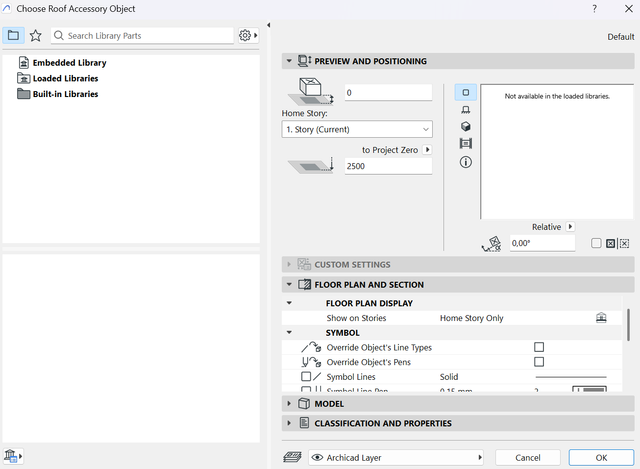

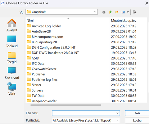

I have been trying to use the roof accessory tool, but after watching multiple YouTube videos, I still could not manage. I installed the goodies. Now I do have a roof accessory option, but the library is empty. And when I try to add it from the folder, then there is no such folder as "Archicad 28" as the forums and videos suggest.
What should I do?

"C:\Program Files\Graphisoft\Archicad 28\Accessories Library" would be the folder you're looking for.
it appears you're in "C:\Users\<USERNAME>\Graphisoft"

And don't just load the folder.
You must load the 'Accessories Library.libpack' file (library pack).
