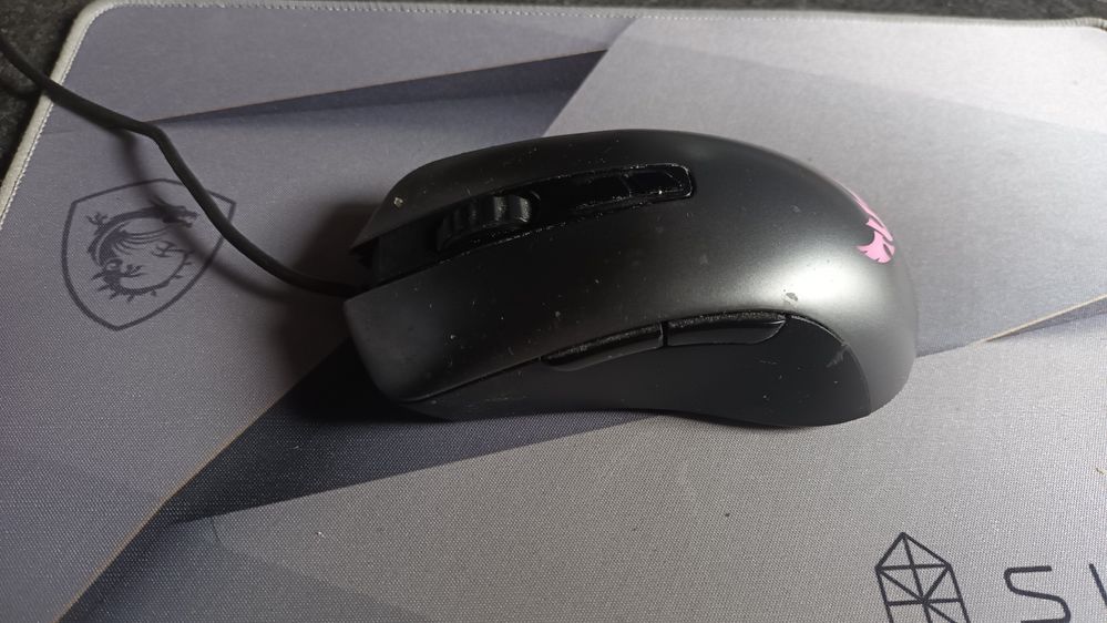

Can I make mouse shortcuts?
3 REPLIES 3
Botonis
Mentor
What do you mean by mouse shortcuts?
Are you talking about macros...? What mouse do you have?
Give an example so we can help.
Greetings.
Civil Engineer, Enviromental Design MSc. BS ArchitectsVR.
Graphisoft Insider Panelist-Archicad 29. Windows 11. Intel Xeon 2699x2,64 GB RAM, Nvidia ny or personal website3080Ti. 2 Monitors.
Balasger
I have an ASUS TUF Gaming M3 mouse, I would like to use the side buttons, as quick buttons to teamwork's "Reserve" and "Send Receive".
Thank you
Look at the guide to set the shortcuts.
https://helpcenter.graphisoft.com/user-guide/88355/
Open the work environment go to the shortcuts tab and set the shortcuts for the commands that you want for example ctr+shift+r for reserved.
Then set these shortcuts to your mouse via the Asus software.
