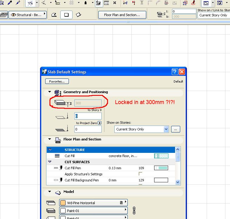

When I start Archicad 10 in its default "Archicad 10 template" everything is normal except when I access the slab tool.
In the part where it says slab thickness it is greyed out and I can't adjust it (its locked in at 300mm).
I'm pretty new to Archicad 10 so I'm not sure if its because somewhere there's a favourite tool ticked where it automatically locks the thickness to 300mm or something.
Any help would be greatly appreciated.
Cheers

the reason you cannot change the slab thickness is because the slab has been assigned to a 'composite' structure: the predefined skins of the composite already have thickness values and so the slab thickness is a function of the composite and not user editable.
change the slab structure (cut fill) to a plain-ol'-vanilla fill - you can then edit the thickness as much as you want.
if you want to change the thickness - or even make your own composite structures - Options>Element Attributes>Composites... and edit away. composites can also be used in walls and roof (depending on whether you specifiy them to be such in the composites dialogue) so you may find the same 'problem' there too!

Thank you ~/archiben for your suggestions.
Just like you said everything worked
I had thought that composits only existed for walls... argh getting use to ArchiCad 10 is going to take a while especially when you come from an Autocad background...
