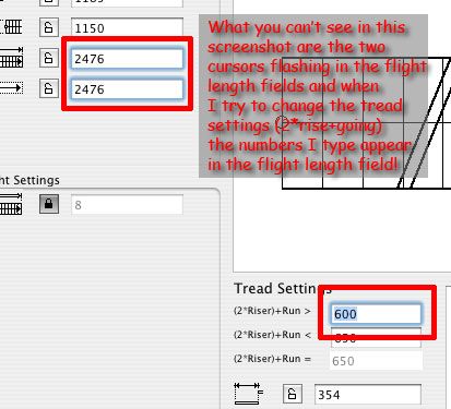

I'm having a problem with the second/main dialogue box in StairMaker. I usually start entering data into the fields at the top left and work my way down.
What is messing me up is that I get stuck as I get an error saying that twice the rise plus the going has an invalid value. When I try to modify that value and type a new value the numbers I type appear in the flight length field instead!
Anyone else had this?

seen plenty of other wierdness in stairmaker but not that one. May need to delete prefs.

Thanks Aussie John that worked.
