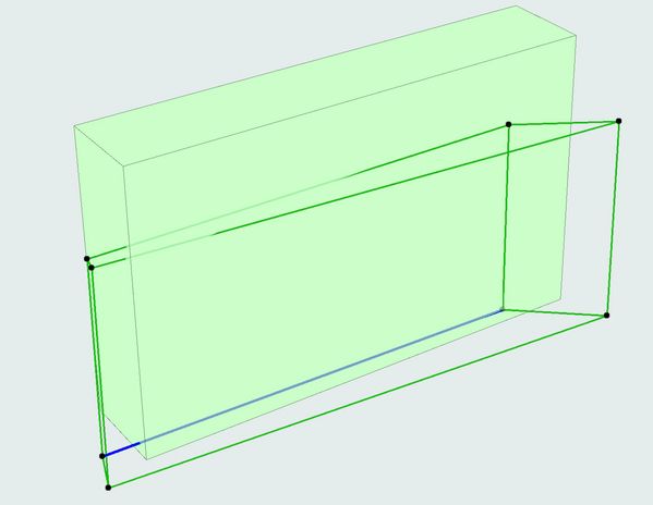

Weird selection
Hello, does anyone know why this is happening? The file opens with basic AC29 settings, but others with these settings don't have this!

Hi
That happens because you're working too far from Archicad's origin. You can fix it by moving your project as close as possible to Archicad's zero reference point. This happens in all 3D software. Sometimes people confuse georeferencing with moving too far.
That should solve it.

jarkwiat
Yes, that solved the problem, thank you, best regards!
