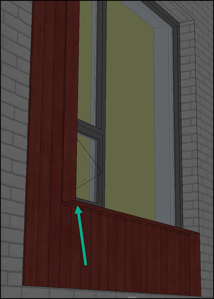

I am trying to achieve something like this;
Using the Opening-tool:

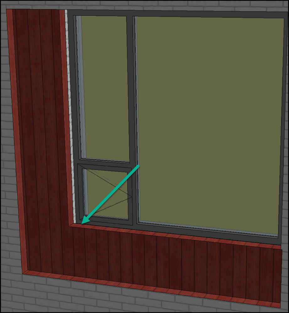

But it somehow makes a weird edge, as shown with the green arrow. Some setting I missed?
Seen from a different angle:

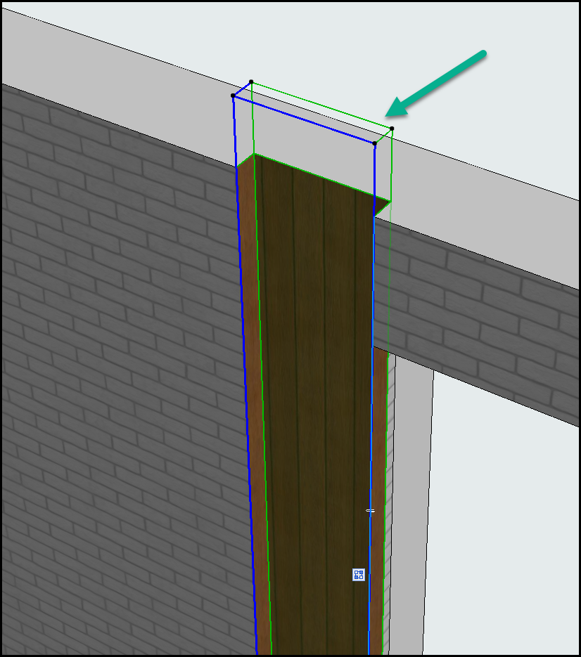

However extended above wall height, what is over wall height disappears:

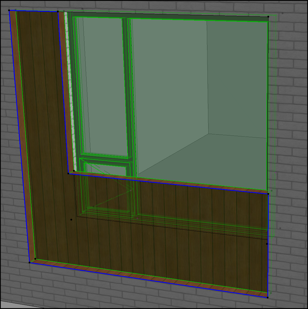

Limitation of the tool. Is there any issue with including your window within the opening? Your example has a black casing around the entire opening.
Kamelite
Then it looks like this:
Windows 10, Archicad 27,28 and 29
Lingwisyer
Guru
Oh yeah, always forget that the limited depth opening does that... Add a second opening overlapping your window.
